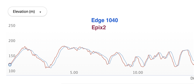

The elevation lag is kind of "within expectations", but a bit later than Epix and further readings much slower which cause total ascent shortage
https://youtu.be/ltctVcPakkI?si=vgUIpcdxohRW0RR9
As you see on graph there is bigger lag than Epix has and because of slow readings Edge graph is smooth

But I kind of disagree about having big elevation lag in another thread. It's related, and it's very difficult to show statistics from gradient lag. If you compare e.g. Fenix7 with 1040 they should have almost the same elevation graph, and lag, now when it's fixed. As I showed in my second diagram on page 52. Before when there was that big gradient lag the elevation lag was bigger for 1040 than Fenix7 (which is kind of funny, why did the tiny watch perform better than 1040).
My point is that if elevation lag is acceptable, also gradient lag will be that, and if elevation lag is to big, also gradient lag will be that.
About Michael_kalina's latest graph, that is about the same which I had when I compared 1040 with Fenix7 last autumn when there was that big problem with 1040. It's a little mystery I think, a HW problem that cause 1040 to act as it was doing with the SW last autumn...

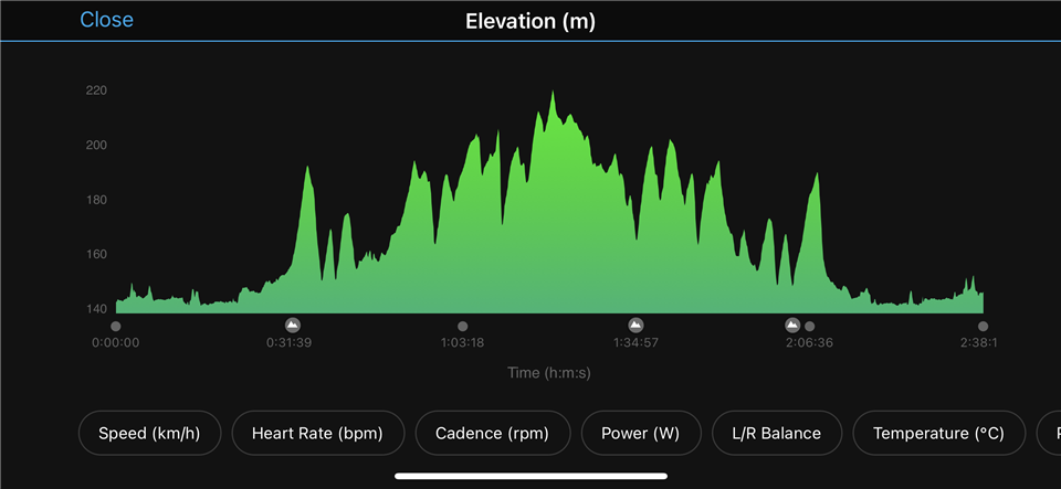

Another data point supporting Michael_Kalina's findings.
Here is my ride data from a short one last night. My Epix Pro from last night is the more detailed red line, the dark blue line is my 1040 on the same route last month, and my Edge 1040 from last night is the smoother blue one.
Last month's ride matched almost identically to my Epix Pro from last night. The odd man out is the 1040 last night.
https://1drv.ms/i/s!AjfmC9r0iGv6maJDcEZF5lUH74LMIQ?e=ub0wUH
The elevation is lagging and the Grade field doesn't change as fast as it did before I came home from the PBP at the end of August.
My 4 baro ports look clear.
EDIT. 1 Baro port. Looked behind the usb cover to find it.
I've ridden the route represented in the graph many times and it used to update much more quickly. Before September.
Something has obviously changed.
