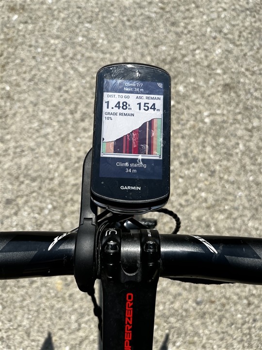

  • OK, one setting that seems to help reduce the lag, is to select recording data every 1 second. Did a side-by-side with the old 1030 yesterday and the 1040 was closer, but still delayed.
    Setting for data recording
