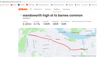

If you view the course in Garmin Connect do you see the start and end flags for the segments

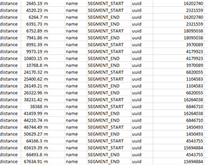

Could you post one of the course FIT files from your unit that went through the process?
Issue still occurs.
Created Route with Strava Routes and synchronized with Star to Garmin Connect. In Garmin connect segments are shown. With synchronization it is copied to my Edge 1030. Riding the course, with live segments the start of the live segment is recognized.
