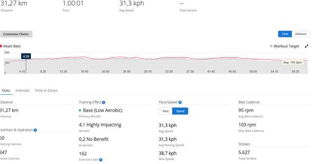

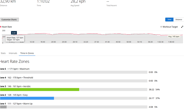

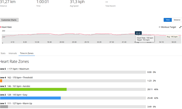

I have done several indoor rides in Octber and November where the majority of the time was spent in Z3 and still it's labelled as "Basic" so the High Aerobic is now totally down to zero. This is absolutely very wrong!

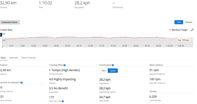

Exactly the same indoor rides done in March of this with all parameters (like HR-zones etc) equal were labelled as "Tempo (High Aerobic). See screenshots hereunder:
In TrainingPeaks I can see that both exercises have the same Intensity Factor so the 13-Nov exercise should be labelled as Tempo just as the 04-Mar one.
