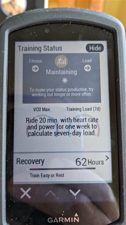

  • Virtually the same thing happened to me. I started using my new 1030 Plus, with HR monitor, two weeks ago. I also use a Garmin Venu 2 and enabled Physio TrueUp on both devices. I do not have a power meter so I was pleasantly surprised and very happy to see that Training Status was working (and updating) on the 1030 Plus from activities recorded on the 1030 Plus and the Venu 2. I also had a new Training Readiness card appear in my Connect app on my phone and it also appeared in Connect on the web. The 1030 even showed my VO2 Max from the Venu 2 and I was even getting "Daily Suggested Workouts".  Then several days ago, the Training Status stopped updating on the 1030 and now shows "Unavailable". The VO2 Max reading is gone also and no more Daily Suggested Workouts. The Training Readiness card is also gone from the Connect app on my phone. Some related things are still available and updating -- such as Load for the last seven days, Load Focus (in the Connect app, but not on the 1030), and exercise load.
    I have read and understand the Garmin instructions about the Power Meter requirements, but my question is why was everything working for the first two weeks?...  and why did it suddenly stop?  It's disappointing because a power meter is not in my budget right now.
  • Well, that's a bummer. Time to sell my first kid to buy a power meter.
  • Enjoy it while you can. Let us know how long it lasts. I started using my new 1030 on July 14th and it looks like Training Status stopped working (status Unavailable) on the 26th (three days ago). On a positive note, I do still have metrics from the 1030 that I didn't have before. Screenshots below from the Connect app on my phone. Guess I need to start saving for a power meter.
