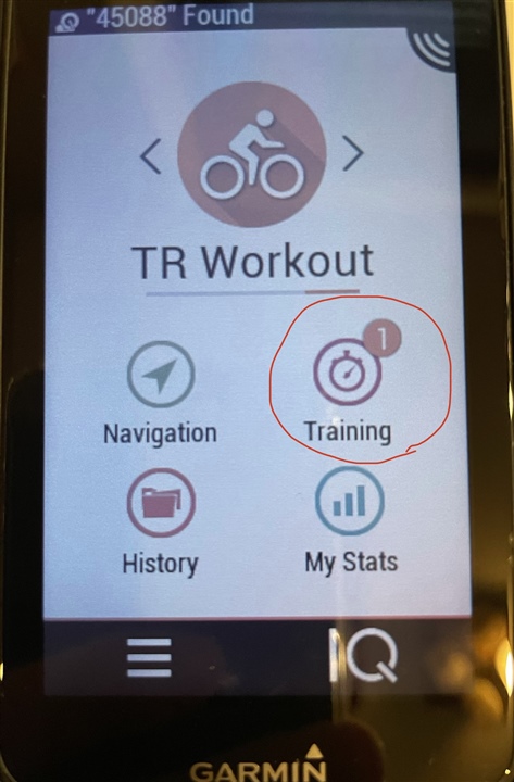

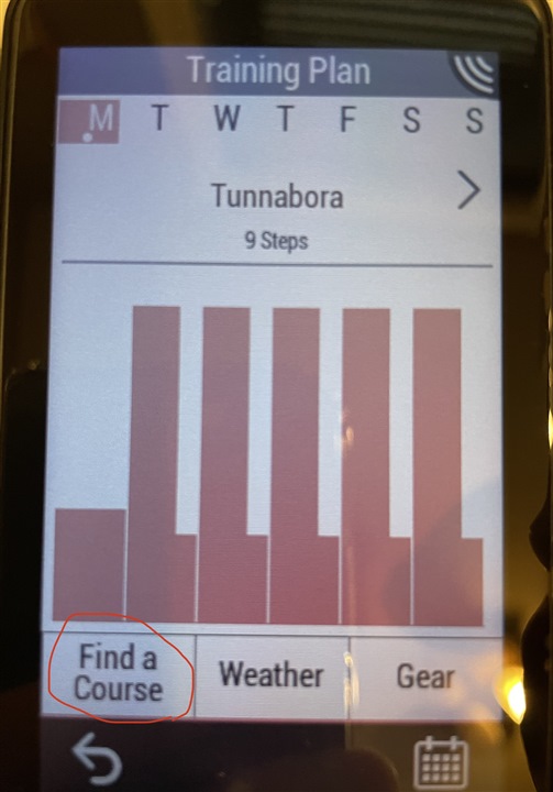

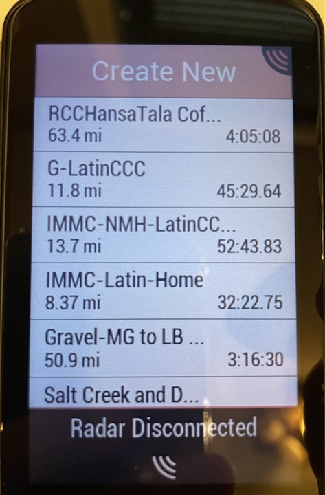

see the attached pics. I select training, then training plan, then then under the workout, select find a course, and choose the course that you want to follow.
when you hit ride then just follow the course and hit the lap key when you’re at the point where you want to start the workout/intervals.
