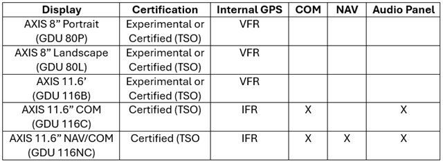

All Displays and Sizes

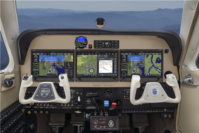

First let’s look at upgrading your existing panel from G3X Touch to AXIS. The Cessna 182 displayed below upgraded to AXIS PFD w/EIS & Copilot 8” Portrait MFD Display. The starting AXIS equipment list price as shown - $16,400.
Other options shown in the panel include: GTN 750Xi, GTN 650Xi, Remote Audio Panel, Remote ADS-B Transponder, Standby G5, GSB 15, & GFC 500 Autopilot.

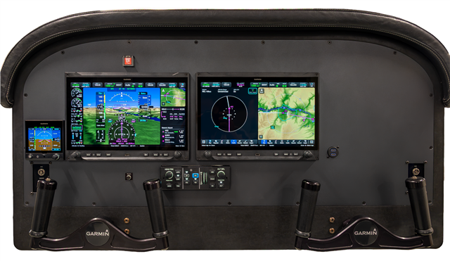

Next let’s explore a panel upgrade that includes 2 AXIS 11.6” displays. The below panel includes AXIS PFD w/EIS, MFD, Dual IFR GPS/COM, single VHF NAV, Integrated Audio Panel. Starting AXIS equipment list price as shown - $50,675.
Other options shown in the panel include: Remote ADS-B Transponder, GSB 15, Standby G5, and GFC 500 Autopilot.

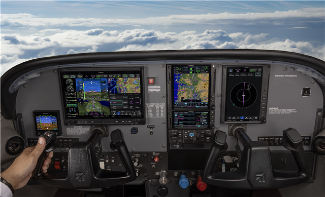

Finally, let’s look below at “All-in AXIS” – Clean slate panel upgrade to replace steam gauges and dated avionics. This installation includes AXIS Dual PFD w/EIS, MFD, Dual IFR GPS/COM, Single VHF NAV, Integrated Audio Panel, Starting AXIS equipment list price as shown - $71,625.
Other options shown in the panel include: Remote ADS-B Transponder, GSB 15, Standby GI 275, GFC 500 Autopilot.

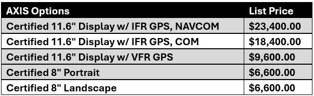

Pricing
