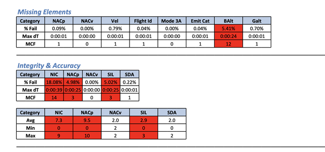

From the very first flight following the Condition Inspection (mid May 2025) through today the XPDR box at the top of the G3X screen (to the right of the COM and standby COM boxes) will flash a yellow "NO ADSB" above the squawked code often and less often (but still often) it will flash a yellow "NO ALT" above the squawked code before returning to the white XPDR. Class C traffic control has not mentioned not having ADSB or Mode C information but I have pulled PAPR reports and they indicate errors in reporting. Exceptions are noted on NIC, NACp and SIL. Missing Elements has red under BAlt, as well.
The avionics A&P is very busy and has asked me to take photos of various screens while flying but no potential solution has been offered. Any suggestions on where I can begin troubleshooting myself? This is an experimental aircraft and I have the repairman certificate.
