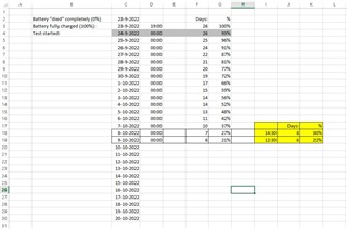

It seems the battery was dropping already quite fast when configuring the watch and the last 10% went to 0% in only 1 hour (no GPS), but then ofcourse backlight is constantly on whenever you press a button. So that's not quite a fair comparison of to the expected batterylife. So I've decided to make a test and record once a day at 00:00 how manny days and the % of the battery is left. I know that "days" is probably calculated and therefore an estimation. So the recorded % will give the best insight.
I've charged the watch to 100% (19:00) and started measuring on daily base on 00:00. I started with 99%, so it only used 1% in a timespan of 5 hours, which looked promising so far.

My test is not complete at the time of writing, since I still have 17% of battery left now. But this are my results so far:
Test results
The yellow fields show some measurements in between the daily measure points, because % was drastically dropping there, without actually something with the watch. But energy was dropping there with 8% / 10% a day.
So now I'm ony 15 days (and a bit) away of a full charge in what I believe "smartwatchmode". And my battery already reached 17%. It now says 5 days left. But like mentioned before, the previous time the last 10% was dissapeared in about 1 hour.

Because in a previous in previous correspondation I've asked how to best check the battery drain. And then they explained me that they put the watch in GPS activity and time it for 30min. And then watch how much % are used. But when looking at the tabel, battery drainage is not consistent. At some spots it  drains 3% a day while on other days it drains 10% in completely the same circumstances.
