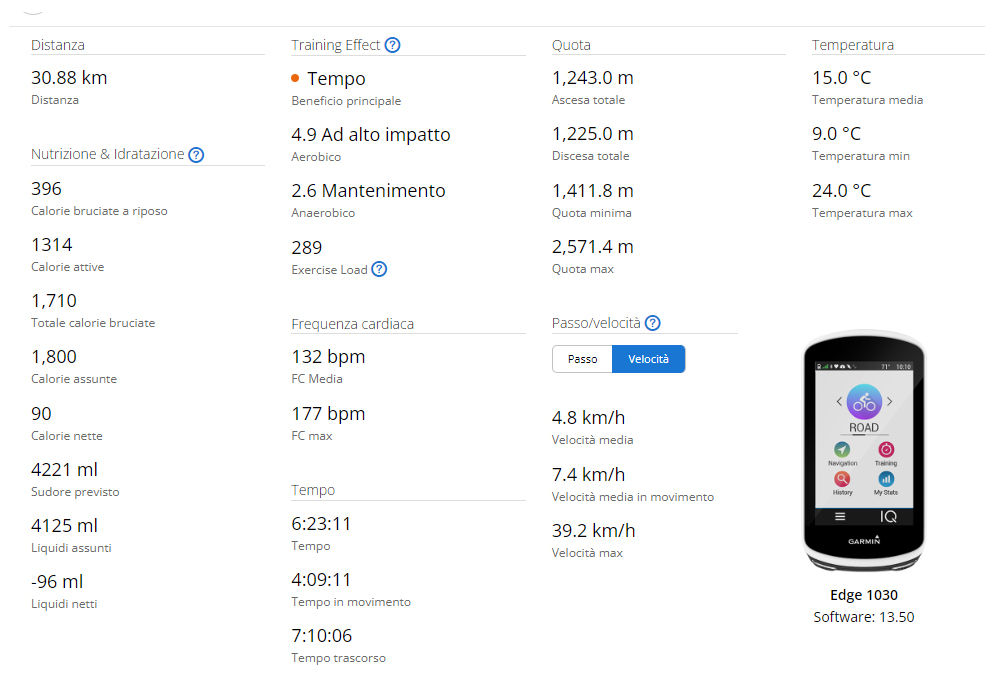

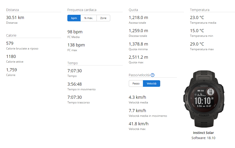

  • I share the data recorded during a bike ride with Edge 1030 and Instinct solar with beta V18.10. For me this version is already better, with the V17.50 the total ascent values were always much higher, sometimes tripled.
