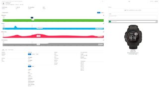

  • In this example I calibrated to 55m Elevation, max alert is set to 56.
    For some reason in the Fit file, the decimal place in the "enhanced altitude" is in the wrong place? I didn't begin at 554.8m, I began at 55m (or maybe 55.48m under the hood)
    Also, despite this change in altitude, the total ascent/descent in the screen grabs says zero.
    A clue to why it isn't working maybe?
