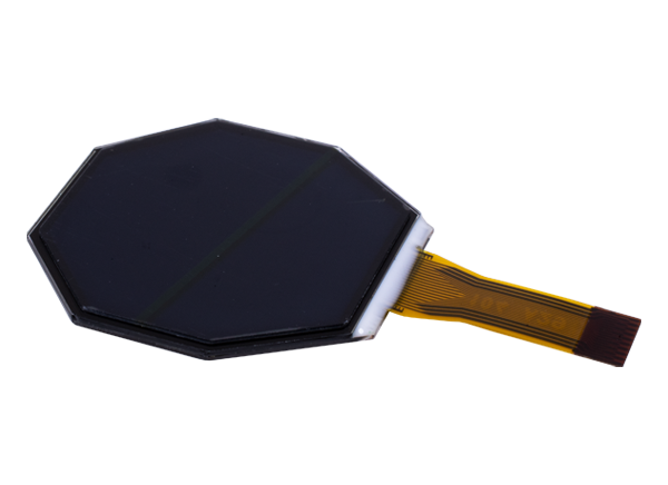

this is the type of display (MIP) used in Instinct. Now imagine what a solar cell placed beneath it can harvest.
Show me where this is the type of MIP used? There are three types. Reflective, trans-reflective and transmissive. Which one reflects light and which allow light to pass through? You're trying, but not hard enough.

According to Garmin specs it uses "monochrome, sunlight-visible, transflective memory-in-pixel (MIP)". It means the light coming from outside is being refected, while it permits to use the backlight. So the problem persists - if there were solar cells on the backside, they would not get any light. On the other hand they could emit the light
it makes no sense trying to harvest the IR and UV light again under the Power Glass - there is practically nothing left.
