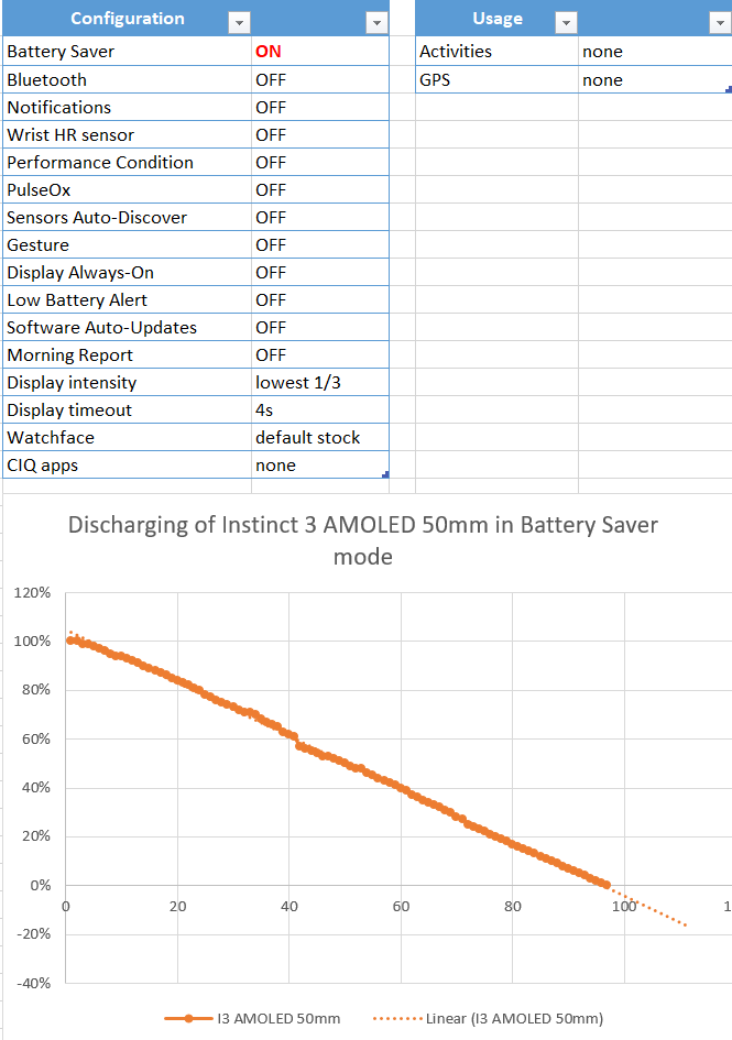

What are your settings for a long battery life? How long does your watch last in smartwatch mode?
See the details on the screenshot of my comparative test of I3 Solar (blue) and AMOLED (orange) below:
Given that the 2 is quite a bit cheaper, and in our experience performed well, would just go with the 2, depending on your use case.
Personally I would not go back to Instinct 2, except if the budget is really the main concern. Besides others, and besides new software features, I especially appreciate the bigger memory, and faster CPU. The AMOLED watch is quite another level, though. Much stabler, much more responsive, huge memory, better battery life than Solar.
However, my favorite Instinct 3 is Crossover, despite its smaller battery. Due to the smaller size (45mm, and also thinner than the non-crossover I3 45mm), when using it 24/7 with 2-3 hours of outdoor GPS activities it holds less than a week. In minimalist configuration, practically just with the mechanical hands showing the time, it holds a month:
I3 AMOLED 50 mm, in similar minimalist configuration holds almost 100 days, though unlike at Crossover, you do not see the time with the display off.
