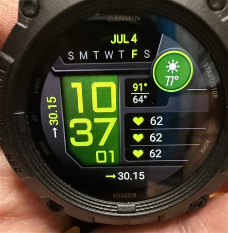

Another pic to show that the HR Data Field is available in multiple locations on a stock watch face:
HTH
