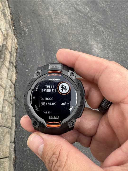

Instinct 3 45mm Solar Charging Issue

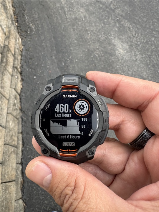

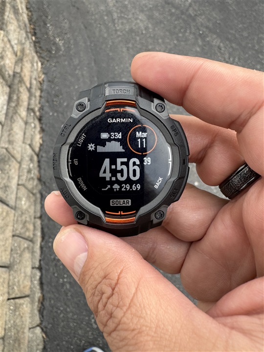

I know that 8.09 was just released but I don’t see anything in the update related to Solar Charging and fixes. I kept my I3 out all day and I was very impressed with the absorption of sunlight that the watch received BUT it does not translate to increased battery life.
After all this charging, I should see the infinite sign (charging began when the watch was at 96%). This is obviously a software issue that should be looked at, in conjunction with the other report of the battery life estimate being wrong when the HR is off.
