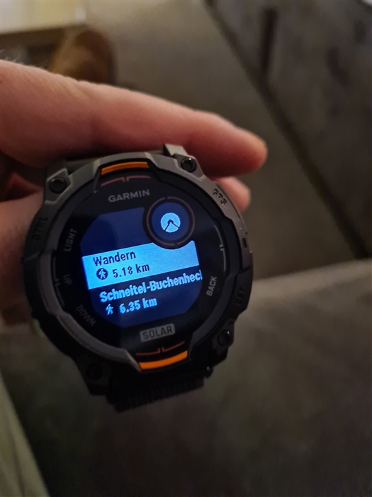

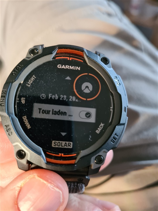

Navigation with Komoot is not possible with my Instinct 3 Solar. I load a tour onto the watch. When I want to start the tour on the watch, it shows "Loading tour" but nothing else happens. It works perfectly on my Fenix. Did I do something wrong?

But the tour is already send to the watch. Only to start the tour is not possible. Two trips are already on the watch

Now I have a solution for the problem. Simply transfer the GPX file of the selected tour to Garmin Connect and then send it to the watch. And (arrow) navigation is possible. Works perfectly

I'm seeing the same thing. The Komoot interface actually downloads the course, but doesn't transition to the activity. I can navigate the course by backing out of the Komoot app, starting an activity and selecting the Komoot course.
