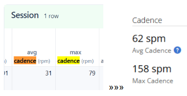

    The following data comes from one of my recent walks with Instinct 3. The FIT file shows the Avg Cadence (single leg) of 31, and the Max Cadence of 79. Garmin Connect the shows the doubled values (for both legs) correctly as 2×31 = 62 spm, resp. 2×79 = 158 spm:
    click for image (embedding rejected)

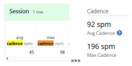

    It looks similarly with your file as well, with the exception that there is a small deviation, likely caused by rounding or flooring the value in FitFileViewer, at the avg value: 2×45 ~= 92 spm & 2×98 = 196
    As a conclusion, apart of the rounding/flooring issue (possibly more a problem of the FitFileViever), I do not see any discrepancy in the data.
    I do not know where you saw the 60 spm in the FIT file, since it clearly tells the avg ½ cadence of the whole session is 45 spm
  • Trying to post the images in a separate reply, sometimes it works. The first one is the screenshot of my own walk cadence data:
    And then the data of your activity:

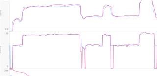

  • So garmin platform includes 0 in cadence value, but strava and intervals.icu not? I wondered why this apply to X2 and not to FR230, but when I compared both devices, there are sections of the graph, where speed is above 0, but cadence is 0. I would expect, that when I am moving, my cadence has to be above 0. Does not it indicate something wrong with x2? Top graph is speed, bottom is cadence and red line is X2, blue line is FR230. FR230 doesnt have this drops to 0 cadence (or at least not so often)
  • I would expect, that when I am moving, my cadence has to be above 0.
    Not always. The watch may not be able to detect the cadence if the arm wearing the watch does not swing naturally. For example when you are pushing a troller or a caddy, holding on railings, ropes, trees, walls, sometimes even when you carry something in the hand, using walking poles, etc.
    It could be due to a damaged accelerometer, of course, too. You best test it by walking some distance in regular continuous pace, with arms swinging steadily and naturally.
  • I did already three walks each 2,5hour long, wearing both watches, trying L/R hand, tight/a bit loose strap and in this particular situation, both watches were on same hand, I wore both watches on my left hand swinging my arm naturally. Thanks for your help trux.
