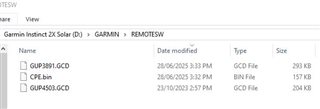

    What exactly does the update show, when you click the button "Show Details" in Garmin Express? When still on the cable, do you see some *.gcd files in the folder /GARMIN/RemoteSW? And which version is at ANT/BLE on the screen System » About of the watch settings menu?
  • thanks for your help. Here is what Garmin express shows when i click on "Show Details"
    I do see these *.GCD Files in /GARMIN/RemoteSW
