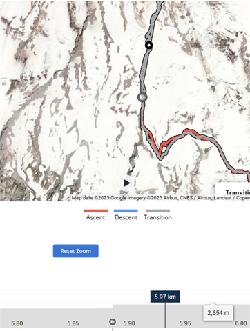

  • The issue is that there is a steep rise in elevation with no change in distance, as seen below (you may have to change the x-axis to "over distance" to see this).  As a result, the elevation gain is not counted for this portion.  It's as if I had stopped the watch from about 8400 to 9400 but I double checked the settings on my phone as you suggested in your original response.  I believe am in a gully in this section, so I'm wondering if the watch cannot get a valid GPS signal, it basically ignores this portion of the track.  I will see if Garmin Support has any thoughts about this.
  • The gap comes exactly at the transition point (the gray round dot on the track), and there is no distance data for the next ~600m (the next recorded track point is the black dot). I suggest that you change the Mode Tracking in the settings of the Backcountry Skiing from "Auto" to "Manual" and tag the ascents, transitions, and descents yourself, since the watch has clearly problems to detects it properly. Possibly because of the low speed, not really because of low GPS signal - the track looks fine.
