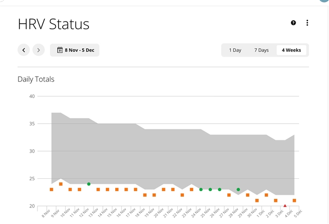

My HRV has been low for a month and is not recovering. I'm not ill, I don't exercise too much and I get enough sleep. Does anyone else have problems with this? My training readiness has been constant at 1 for a week. No change, as if it was frozen. I find this strange. Could the watch be broken? It's an Instinct 2s Surf, I've had it since 2022 and it's always worked. I didn't wear them for about 3 months in the summer and since I started wearing them again (mid-October) I've had this problem. What can I do?

    That's another problem participating to it. The baseline adjusts automatically to the long-term changes in HRV, but you have to wear it in order to get the updates regularly. By not wearing it, the baseline remained on the level from the Summer, and now drops only very slowly to your current level (while your current level drops too, due to the coming Winter).
    What can I do?
    You do not need to do anything. After a few more weeks, the baseline will drop sufficiently low to get you into the green. Well, you could reset the watch to the factory defaults - that would force the watch to reestablish the baseline from the scratch anew. However, it will take also couple of weeks, so you will not gain much time.

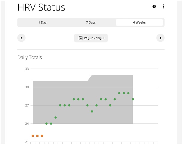

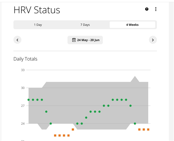

    i check my last measurements before I stop wearing the watch and it seems you are absolutely right with the baseline
  • That’s the baseline I had in June and July before I stopped wearing the watch
