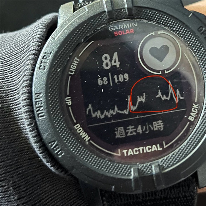

I am attaching some screenshots for your reference. You can clearly see the reboots during heart rate drops or power spikes...
