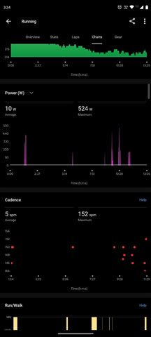

After the recent update of 15.08, my run activity can't record accurate cadence or power. I have updated the firmware to 16.10 and the problem still persists. Similar problem when I tried recording a hike. Anyone else facing similar issues?

BTW, does the watch count your steps correctly? Could you check how many steps it counted during the activity shown on the screenshot? You can see it on the daily Steps graph - check the value before and after the activity.

As I wrote, check the number of steps done during the activity, and compare with the distance. You can easily calculate whether it corresponds to your average running stride length (at an adult male it is typically around 1m). If you find you really get much less steps than you should, then as I wrote, contact the Support, a replacement of the watch may be needed.
Right! Apologies for misunderstanding the question earlier. I checked the step counter from the day and yes, the step counter averages about ~3.5k steps, against the SPM of 5 during the run for 14 min, totaling to 70 steps.
So definitely a glitch within the Run activity(?)

Strange indeed. The activity shows 3686 steps, which is corresponding well to the estimated distance of 3km. And since the time of the activity was 1494s, the average cadence should be 148 SPM.
The data file misses completely the values "directDoubleCadence", "directFractionalCadence" and "directRunCadence", at almost all data points.
The only thing that is a bit out of norm, is the low quality of the GPS signal, but that should actually not matter at all for the cadence, since the accelerometer is used for that, just as it is also used for the distance estimation. And the distance seems to be reasonable all right. Despite it, I'd recommend doing a short run in open space under good GPS conditions, further away from buildings and dense vegetation (may be quite challenging seing the temperatures in your place).
I am afraid you'll have to contact the Support for further investigation. Other than doing the test in open space, there is not much you can do, if you tell the master reset to factory defaults did not help either.
... there is another thing that just crossed my mind - in fact the calculated average cadence of 148 spm is extremely low for a run. Standard average cadence at experienced runners is rather close to 180 spm at normal pace (may vary a bit with the pace and the body height, but 180 is considered as the golden standard, although it may not be always true). So perhaps your cadence is simply below the threshold used by Garmin to switch from the Walk to the Run mode. You can try increasing the cadence considerably, without increasing the effort or the pace (making much smaller steps). Not only it may help with the cadence detection, but your joints will thank you too, and your running technique may also improve.
