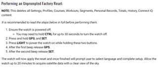

    I am sorry to hear you are having this issue. The infinity symbol would indicate that there is sufficient battery charge for this to last indefinitely. This could be accurate if you have the watch in battery saver, even if it has been a few days since charging. However, if you are seeing this draining fully, but never showing the battery level, I would recommend the following steps:
    • A hard reset. For this, hold the Control button until the watch shuts off, as opposed to selecting power off. Then power this on again.
    • If this continues to drain without showing the battery level, I would recommend completing a factory reset with these steps:
