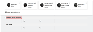

  • Wow does Instinct 2 series support Pace Pro? Seems the specs on the official site show no support.
    I do not know why it is not in the specs, but all I2 models have the PacePro feature.
    Instinct 2 Series Owner's Manual - PacePro Training (garmin.com)
