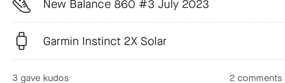

    I don't believe this will make a bit of difference with respect to the OP's issue.  The I2/I2s come in solar and non-solar variants, but I expect that Garmin stamps the same product ID in the activity file for both variants.  The product ID is what Strava keys on to display the device type.  The I2X only comes as a solar variant so your device name with "Solar" tacked on the end makes sense.

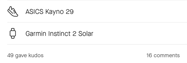

  • I can see for two users its showing correctly. Below is the screenshot from their activities.

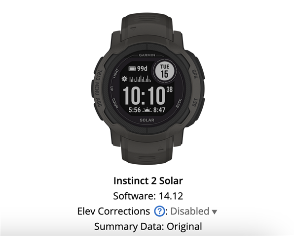

  • This is a screenshot from Garmin Connect Web showing the device name.

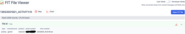

    I downloaded the FIT file for one of my running activity and opened on a website. Below is the screenshot of the file id row. Product shows instinct2. Is this what Strava picks up?
