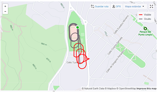

I've been having some very weird results with my Instinct 2X and the track run activity, this is from yesterday's run:
(All screenshots are from Strava, but the map is identical on Garmin Connect).
This was last week:
In both cases the instant pace (during the exercise) and overall distance (after saving) seem correct, but the map is wrong!

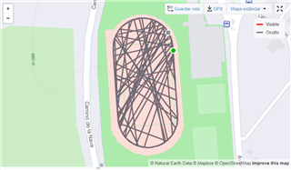

I did have a go at setting the GPS to the max accuracy setting, with the following result:
Needless to say, this isn't an improvement :)  (And in this case, the pace was completely incorrect).
