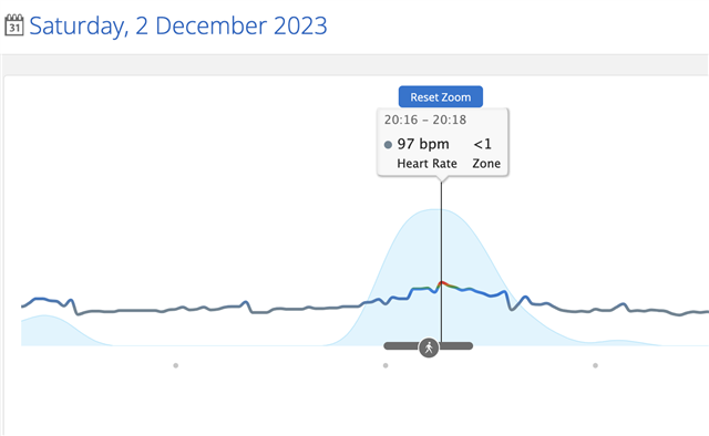

Here is what a 20 min walk looked like yesterday:
Here is what a longer walk (on the same track) looked like today. Note that the entire heart rate line is constant grey, and the heart rate is comparable to yesterday:

  • Note that the entire heart rate line is constant grey, and the heart rate is comparable to yesterday
    Yes, having the graph red at just 97 bpm is indeed suspicious. It looks like either the Max HR was way too low on that day (somewhere near 100 bpm), and/or the HR Zones were incorrect. Red color on the HR graph means you've been in the zone 5. Compare the HR Zones of both activities, or share links to them here.
