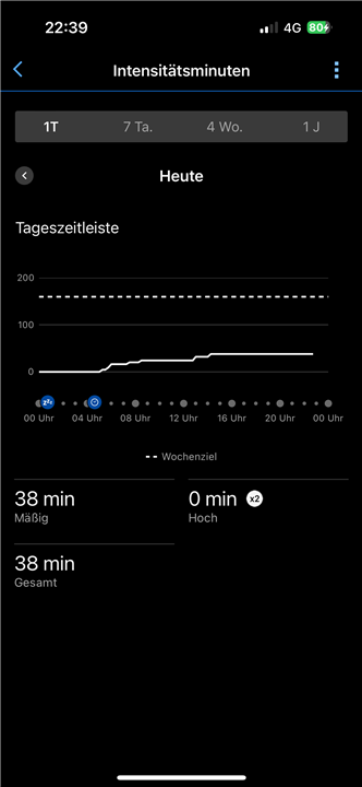

I wore both watches today as described above.
Tonight at 22:39 I synchronized the tactix first. The recorded value for today appears in Connect.
38 minutes of intensity.
Immediately afterwards, I synchronized the Instinct 2x. This recorded 248 (!!) intensity minutes for today.
The "primary smartwatch" setting seems to be obsolete if the values are IGNORED in Connect and are given priority by the values of another NON-primary device.
sync tactix 7 - primary smartwatch :
AFTER Sync 2x solar NONE primary device :
