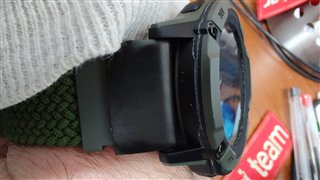

I am having difficulties with the cleaning of the watch. I use a very soft toothbrush but sweat and dirt remain, Any ideas?

Thank you for your suggestions. I do all the above, dry ot most of the times, cleaning it with a soft xloth but the white keeps remaining.

My old watch did. I used to rinse it and not wiping it out often. The water in Greece is very hard. My Garmin Instinct 2 bought since april is still like new.

I just checked my almost 2 years old Instinct 2 with a magnifying glass, and I do not have any such deposits anywhere on it. And frankly told, I never cleaned it with any brush, and also do not care much about drying it after rinsing. All I do it is rinsing it quickly after each sweaty activity, and letting it for some 10-20 minutes in clean water after swimming or diving in the sea.
I use it daily outdoors, and often in the sea. Nothing of it results in such dirt, so I wonder what exactly you do with the watch. Isn't it a soap residue? Or is the tap water hardness exceptionally high in your location? Do you work with some chemicals, in construction industry, or similar?

Well, if it were not a watch, you could use vinegar for removing limescale, but that would do no good to the sealing, and to other parts of the watch, so that's to be avoided. Try distilled water or 90% alcohol.
I used 5ml vinegar in 95ml of water in my previous watch and the barometer stopped working... :-)
So, i will try 90% alcohol since i tried distilled water.
