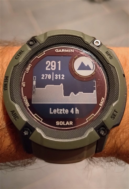

Hi there,
I got an issue with my instinct 2x Altimeter,
When the watch was new it run absolutely perfect, it calibrates over night an then stays at the same lvl, it detects small changes very well. For example wenn I am going up one floor it adds 3 meters and than stays there. If I go down the same. Outside when I was hiking or biking the same.
Now for some Reason, the Altimeter goes crazy. Over night it looks like I sleep in an elevator and when I calibrate it manually it takes one or two seconds an the watch goes down or up for a few meters. Also when I am just sitting around.
I don't now if the error comes from the hardware itself or with an software update, did anyone else got these problems?

    After a few more days of observation i think that the Altimeter works correctly. Stays at the same lvl an then gets a drop or increases the altitude. Testet over night in and outside, left the watch outside to see whats happens. its like 9820003 said, something has Change with the last update. Altimeter is way more effected by changes in air pressure while there is no movement. i did not know if this just happens to a few or every instinct 2x user. but i like it better as it was

    After a few days more I think the sensor is fine, but it looks like the auto mode for the Altimeter did not work. I hope Garmin is going to fix this issue with the next update.
  • it looks like the auto mode for the Altimeter did not work
    I would tell the opposite. The watch detected sharp changes of air pressure, which could not be attributed to be caused by the weather, hence it switched to the altimeter mode. That's exactly how it is designed to work. The problem in not the auto mode, the problem are the sudden atmospheric changes. As long as you do not find why they were, the watch will behave exactly in the same way if it happes again.

  • I have absolutely no such problems after the last update. And it is probably the case for others too, otherwise we would see many more complaints here.
    Some dirt, deposits, sweat, or moisture could cause pressure changes like in your screenshot. Such rapid changes are unlikely to be coming from the weather, so it is logical that the watch interprets them as motion induced, and switches to the altimeter mode. Unless you find out what causes the pressure changes, it will happen again.
    Get an alternative accurate barometer and log the pressure changes with it, and then compare. If the other barometer does not show any such changes, then there is a problem with the sensor - you will either need to clean the sensor port orifice, or you can try requesting a replacement device from Garmin.
