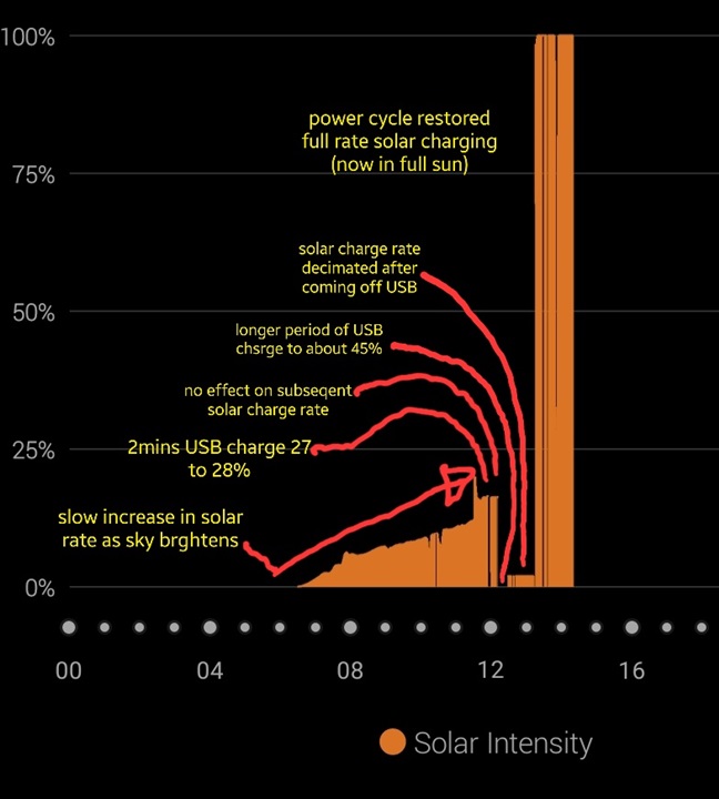

  • Ok, so I've just done a few tests.
    Watch has been sitting in the window for a few hours, graph shows solar charging. Its not in full sun, but the graph is ramping up as expected as the day brightens.
    Connected to USB for 2 minutes, enough to increase from 27% to 28%, then returned to window.
    After 15mins or so check solar graph - it has resumed solar charging at the previous rate (about 20% of max solar charging rate).
    Returned watch to USB charging, left it a while longer this time, up to about 45% charged (it showed 10 days), then back to solar charging.
    Looked at graph after about an hour - the graph has dropped to just above a trickle charge, despite the sun having now come round to full illumination on the watch (previously the sun was behind the window).
    Power cycled watch and returned to window. Checked solar graph after about 20 minutes. Yup, the graph has made a step-change up to 100% solar charging rate (the expected rate under full sun).
    In summary, throughout the battery has been below 50% charge. After a short (2 mins) period on USB charging there was no adverse effect on solar charging. But after a longer period of USB charging the watch then failed to take solar charge properly, instead limping along at a few percent solar charge rate even under full sun. A power cycle instantly returned full solar charging
