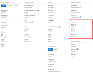

    I've never did this, and used to have heat acclimation in summer. I guess it is related to that recent reports don't have temperature "section" at all. I checked it and 10.10 was the last version which had this kind of data:
  • I guess it is related to that recent reports don't have temperature "section" at all.
    They do, but you have to enable the Temperature recording option in the settings of each respective activity profile, since by default it is turned off at most sports (except of at OW Swim, and perhaps at a few others). However, that's not the Weather Widget Temperature used for the Heat Acclimation. It is the temperature measured by the internal sensor (hence rarely showing the ambient temperature, except if kept in away from the body, or when used in water). The internal thermometer cannot be used for the acclimation.
