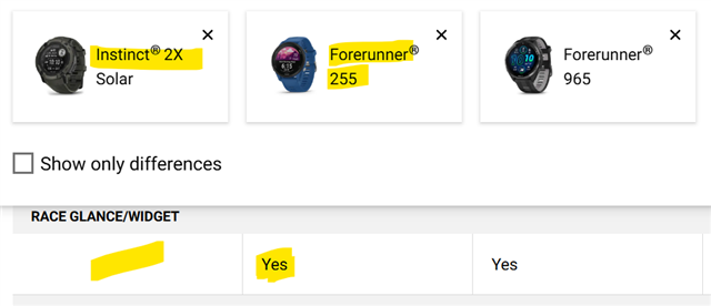

  • I think I understand now the problem you face. On my mind you do not use any Coach Plan, and rather just the race plan, which is in fact just a Daily Suggested Workout adapted to the race. This feature is indeed not available for Instinct 2. Use the true Garmin Coach plan, or a Self-Guided plan instead. Or just the Daily Suggested Workout.
    Or use your Forerunner for that. The device has to support the "Race Widget", and Instinct 2 does not have it:

  • No plan but by entering a race date and information you get daily suggested workouts which populate the calendar (for several days ahead)
    As I wrote, the Race feature is not supported by Instinct 2. Only classical (non-race) Coach and Self-Gudided Plans.
    irritating, can you switch these off?
    Yes, you can. In the Run » Menu » Training » Workouts » DSW » Today » OK » Settings » Prompt Off (if remember well)
    What a strange oversight.
    Not an oversight. Race is not implemented intentionally on Instinct 2.
