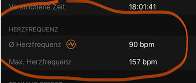

Ok, here is the heart rate graph:
Here again via screenshots my settings for intensity minutes in Connect :
Summary :
During my 18 hour recording, I spent just 4 seconds in zone 4 and 0 seconds in zone 5.
