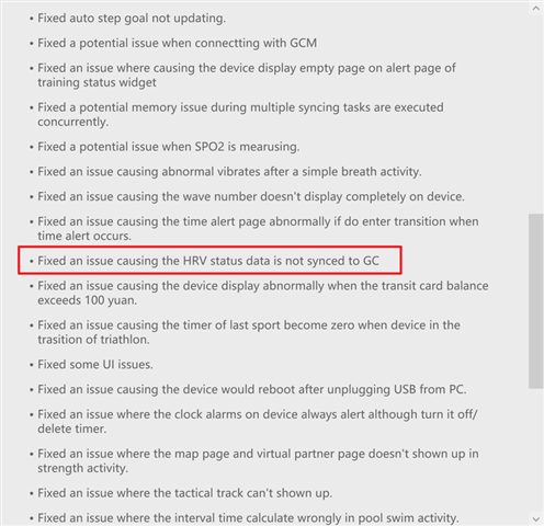

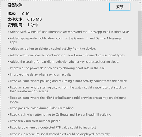

Thanks to Garmin, HRV sync issue is resolved in 10.10 update.
BTW, there are much many issues listed in the log than I thought, hope they are really fiexed permanently. Happy day!
