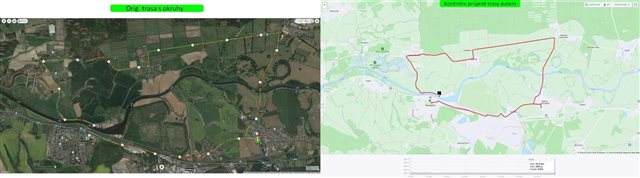

please, i completed a running activity equipped with Instinct 2 solar + HRM PRO Plus this Sunday 11/27/2022. I planned this activity in advance and knew that the distance would be 16,5 km. To my surprise, i found that according to my watches, i had covered 17km with 3km physically left to complete the activity. After the ending of the activity, the watches recorded a total distance of 21+ km. The GPS setting was GPS+GLONASS.
Yesterday I completed a next "test" run with GPS+GALILEO setting and the watches recorded 5,6 km compared to the real 4,8 km. The firmware version was 9,27 in both cases. If this is happening only because of the update, it is definitely wrong.

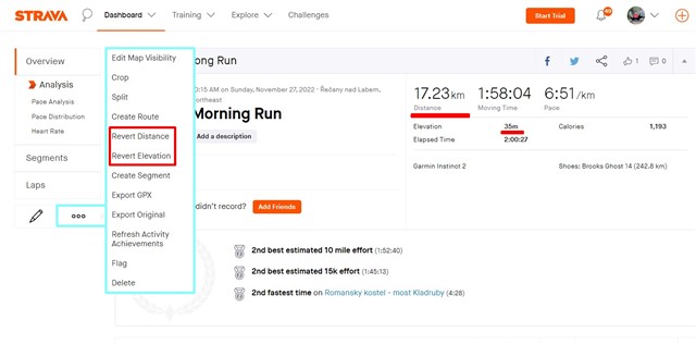

I checked the map data vs the activity record and watches tracked each km after approx. 840 meters. In the STRAVA service i discovered that it can correct device inaccuracies through the recording - this service corrected the record (distance and elevation) with absolute accuracy. I also checked the previous x activities and they were all fine.
