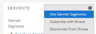

PS: if Segments are not visible in Garmin Connect, it is also possible to activate them over GC Web, but it is a bit trickier to find the option - there are no settings on the page Training » Segments, but you can add the Segments card to the Dashboard (if it is not already there), and then the option is in the settings of that card:

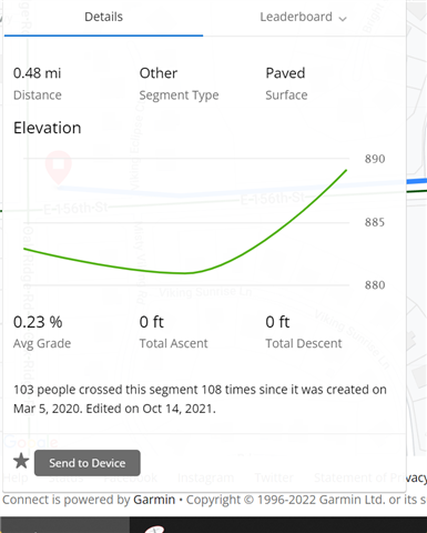

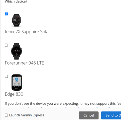

Agreed. I was just trying to point out the Strava and Garmin Segments can coexist on the same device and still activate the Live Segment function of the watch. From a run earler today with my f7:
Garmin Segment sent to watch as I describe above:
Strava Segment:
As you said, you have to select either or to get the full functionality of segment synchronization.
