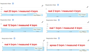

    As I wrote, it is just an illusion. It will always just show the breathing rate prescribed by the breathwork exercise, not the real one. At least it was the case with me, when I tested it. You can do the same test too. See my results for 6 different tests below on the image. I did the workout exercises in identical way - sitting at the desktop, no moving, no diving, of course.
    Using the 6 min breathwork exercise Focus & Relax. Counting my breaths carefully, and keeping it identical during the whole workout. The first test was with some hyperventilation during the whole time (20 breaths / min), second one was with normal breathing (12 brpm), third one was following the prescribed rate 4 brpm (4-4-4-4 / inhale-hold-exhale-hold), the 4th test was done slower than prescribed - a breath each 30s, the 5th test was just a single breath each minute, and the 6th test was a long breath hold. In all 6 cases the prescribed 4 breaths / min were incorrectly detected (with just some brief small deviations of maximally +/- 1 brpm)
    Then, I repeated the test wearing the HRM-Pro, and hoped it would work better, but in fact it did not detect any breathing at all. Also no graph for the breathing rate with the HRM-Pro:
