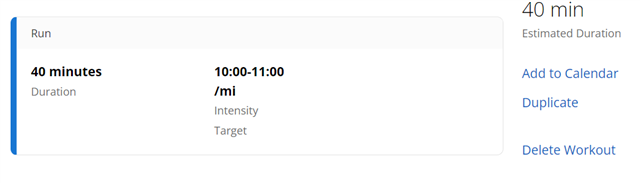

  • This is what my workout looks like (I have adjusted the pace target since I started this thread, but the same thing happened to me this morning... alerts and then pace within target range). But also, if it were going by a HR alert, why would the watch display the pace and not the heart rate?
    HR alerts are not a part of the workout. You can enable/disable them in the settings of the concerned activity. They are independent on the workout pace alerts.
