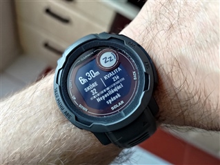

How do you set your sleep time in your watch? You probably also have the latest SW, don't you? What is displayed on the sleep widget and in the GC?
last 4 days similar problem - no sleep in Connect, but on the watch there are sleep data
