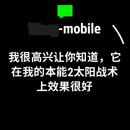

    Just for reference, it looked like this on my epix Gen2:
