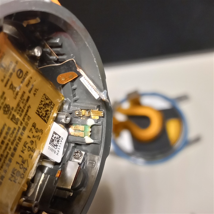

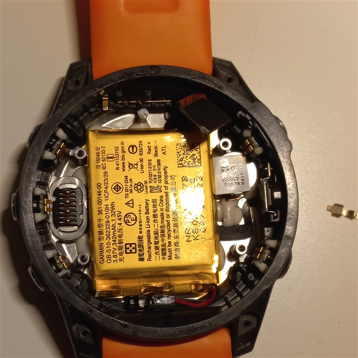

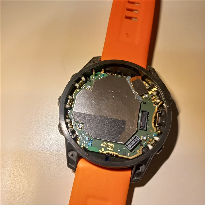

So I decided to take the watch apart. I didn't find any problems with the copper pins that make contact with the motherboard.
However, I saw oxidation between the steel button and the “4-pin dome switch.”
I cleaned all button / "4-pin dome switch" with WD-40 for electronic contact.
Everything works correctly Thumbsup
I hesitate to put silicone grease between steel button and "4-pins done switch" to protect again water...
