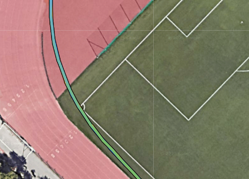

Main course after calibrating
It does not look it was really successful. The entire calibrated track is rotated some 15° clockwise in comparison to the physical track. If you zoom on the map to the max, you can see that the calibrated track goes though the football grass field on the left and right corners, and even when it goes through the true track it changes the lanes from #1 to #8. I am afraid that it cannot really work.
