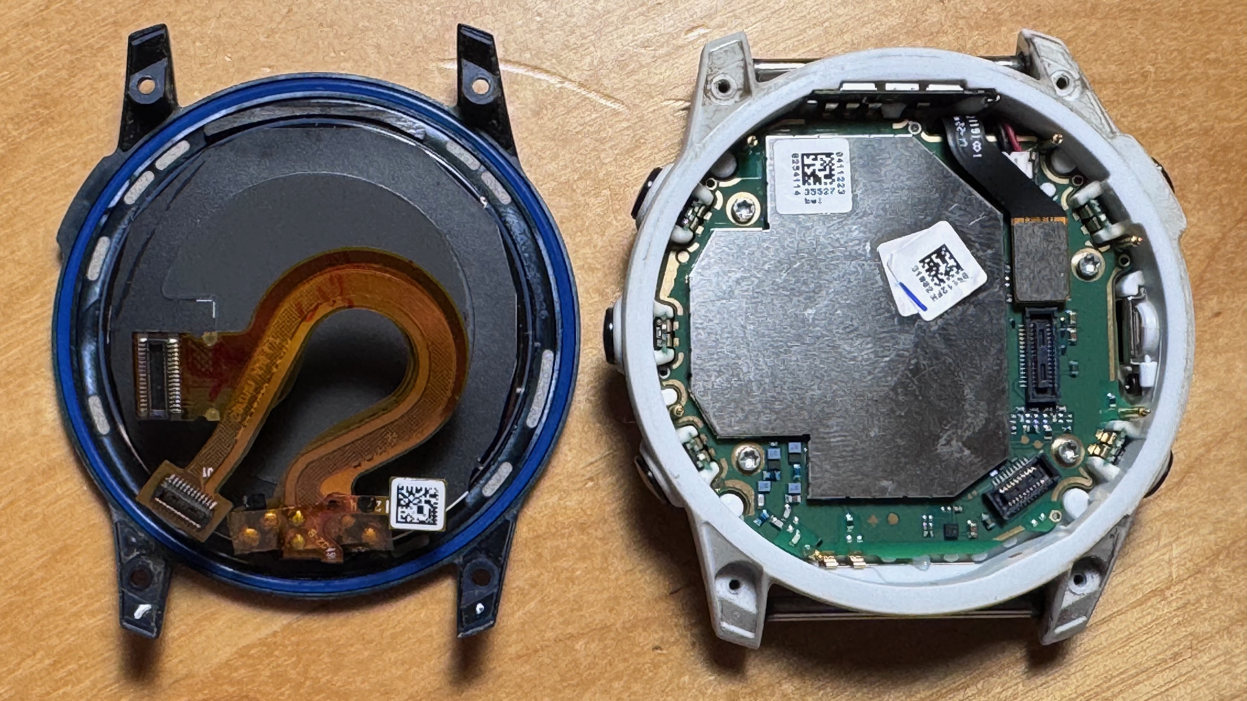

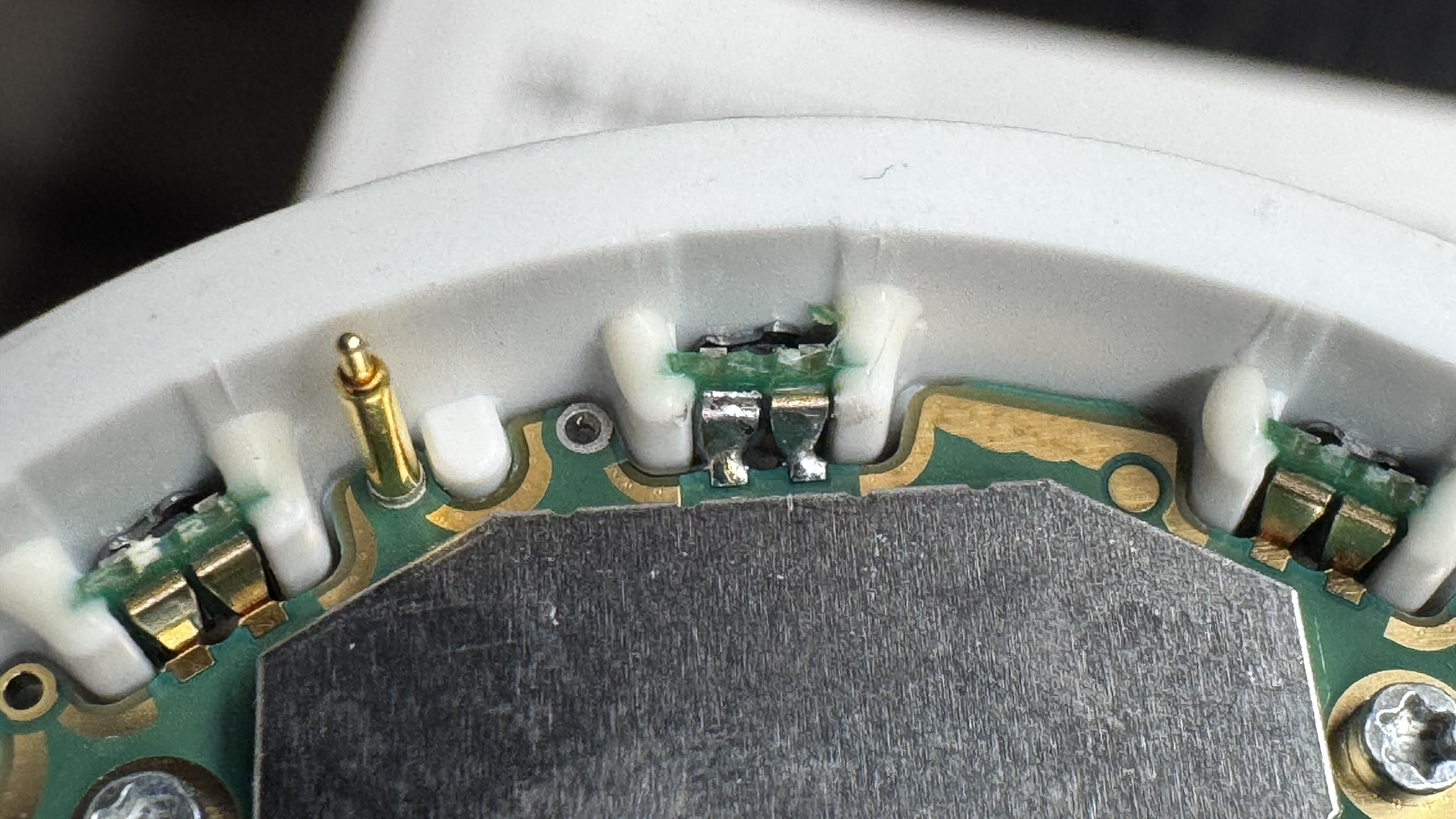

  • @2529455, it is not that the two contacts were shorted, it was that the two contacts didn't make contact with the edge of the main board. I had to bend them towards to main board, so that when the board was put back, they were snug, and pressing against the edge better.
    @meuhbat, here's a picture of the bezel and the housing, you can see the blue O-ring, that would sit on the rim of the housing.

  • I just wonder why is it always the up or the light buttons affected only? All buttons are the same. And these are the least used buttons, in my opinion, so these two should show metal fatigue the least. Although, this "metal fatigue" theory may be incorrect, as the contacts don't move, they just press against the edge of the main board. For now, I'm OK, the next time one of the buttons stops working, I'll take a closer look at those contacts. I don't want to open it up again. I thoroughly cleaned the rim, and applied a thin layer of O-ring silicon lubricant on the O-ring, it should be good as new now.

  • I tried this on my Enduro 2. Menu/Up button gave in. My repair was unsuccessful. So Im posting here as a warning. When bending that small little plate back outwards - BE VERY CAREFULL. Your should be moving it very gently, like 1/2mm - 1 mm only (maybe not even 1mm). Very easy for that small plate just to break off almost instantly. Both of the small plates on my one button went. So now there is no recover from this.
  • Your post couldn't have come a better time, my left middle button became inoperable again. So, with the new knowledge, I took the watch apart again, and was very careful bending the tab. But I broke it, nevertheless. :-( Gaaaaah!!!!
    However, I fixed it... ;-)
    It will be hard to remove the main board, if I ever want to change the battery later, but this button WILL NOT GO DEAD AGAIN!!! :-)
