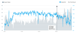

Here I'm biking on a flat oval track at near constant speed - no incline, no wind, no change in effort. Suddenly, the watch thinks my pulse jumped up:
Here is the heart rate vs speed of the same activity in detail, the speed units on the right are in km/h:
It spiked up right when I actually slowed down a bit. Makes no sense. Believing the watch at first, I tried to bring my pulse back down by going slower to no avail. It stayed up.

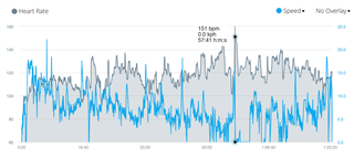

This is very frustrating when I'm trying to use Garmin Coach that assigns activities where I have to stay within a certain pulse range. Here is one such cycling workout where I was supposed to stay at 105 bpm +/-7, so 98 to 112 is acceptable for the watch. When you go outside of it, you get marked down with a bad execution score.
My pulse measure fluctuated wildly between 100 and 140, way above 112 most of the time. I desperately tried to get it down. Look at my speed! Again, it's in km, not miles, per hour. 5 km/h is basically walking speed! This is a 1.1 km loop around a lake, completely flat. People were looking why that dork was riding his bike around the lake slower than a mommy pushes her baby stroller. I even had a jogger lapping me! Biking at that speed is near effortless, more coasting than biking.
At some point, the watch jumped my heart rate to 151, and I got so frustrated, I stopped (see speed = 0 section) and took my pulse by feeling it manually twice, once on my wrist, once on my neck - 78 and 80 bpm. Yes, that's about how I felt too, but the Fenix insisted my pulse was 126. A ~60% error margin! Ridiculous.
A Garmin Coach workout like that is useless, a complete waste of time. Not only does it have no training effect towards my goal, but since the watch thinks I'm exerting myself by biking walking speed it adjusts the training plan as if I had just started fat camp.
Is this a hardware issue? Software? Something I can do?
