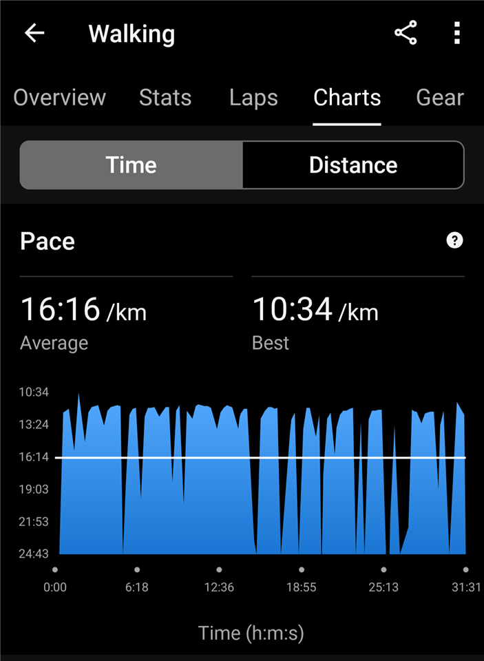

Hi, since the last update, when I walk on my treadmill, according to my watch (7S Pro), my speed varies greatly, but my treadmill speed is constant and my arms swings normally. Steps are all being accounted for. I do choose an indoor walk activity so it ain't a GPS issue. My treadmill speed was set at 3 mph (4.8 km/h). Of course, the recorded distance is also being miscalculated. Wearing my Garmin foot pod makes no difference.
The screenshot below shows my treadmill walk activity from yesterday.
Notice all the speed dips. Below is an activity from before the update. Look how constant the speed was.
There is a similar thread about distance being wrong but it's with a GPS activity, mine isn't so not sure if it's relates or not. Anyone seeing something like this?

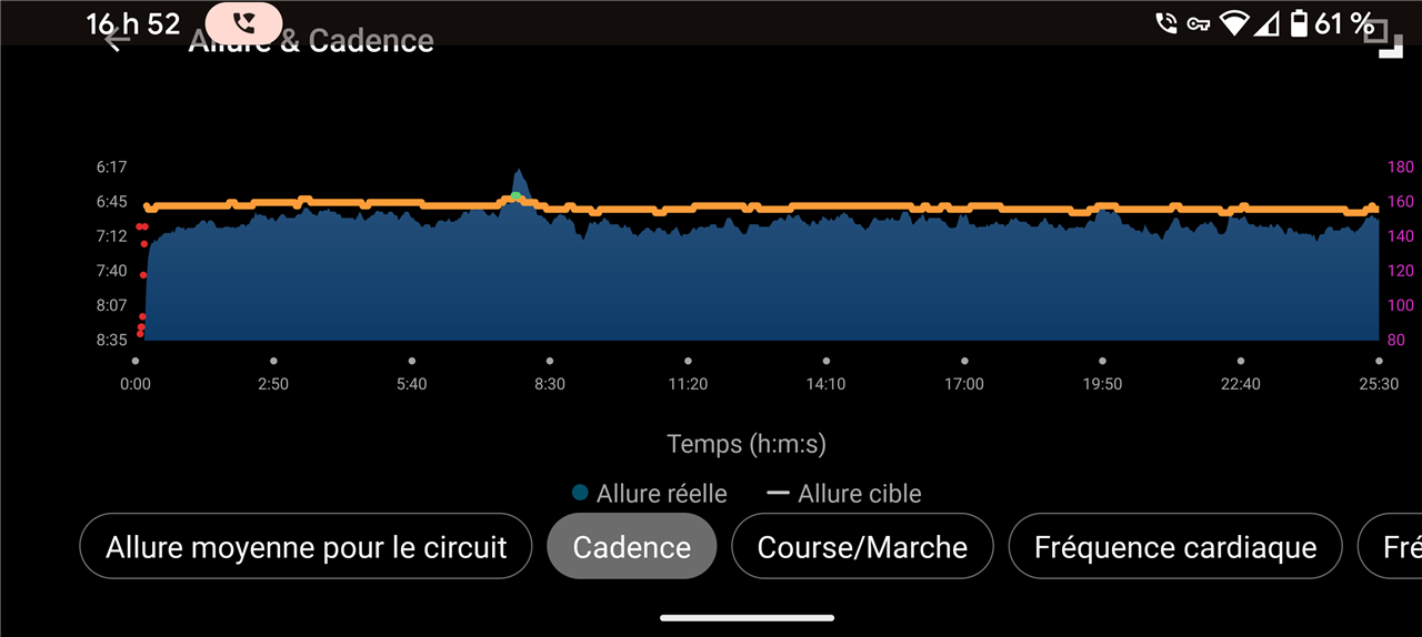

  • I see similar gaps in my indoor walks when the cadence drops below ~95 spm. Could you open the cadence chart in the full-screen mode, add the pace as an overlay, and post it here? Also try recording another indoor walk activity with a higher cadence (not necessarily with higher pace, just shorter stride), to see whether the cadence is the culprit. If so, the information may help Garmin to quicker localize the bug and fix it, once you report it to the Support, and send them the data.

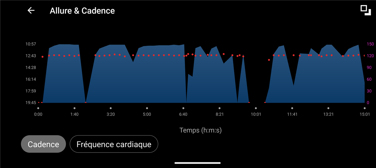

  • My cadence drops to zero, however, IIRC, my steps are still being recorded during that time.
    It's in French so Allure is Pace.
    It's raining today again so I'll probably do more steps on the treadmill. I'll pay a closer attention to the steps as my speed drops to zero.
    Yes, it is the same in my case too (though I am using Instinct 3). Once the cadence goes under 95, the chart stops showing it (despite that the steps continue to increment), and the pace drops to zero (resp. to 1 hr/km), just like in your case. It looks like there is the threshold of 95 spm (may perhaps differ from model to model) at indoor walk, under which the watch considers you do not walk anymore. Hard to tell whether it is a bug or an intentional feature. Garmin will probably claim the later, although it does not make much sense (at least not with the threshold so high).
