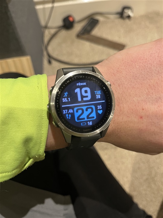

Help! Have I lost this file? Won’t sync and just says invalid. Any ideas? When I went to click save it either crashed or the battery died.

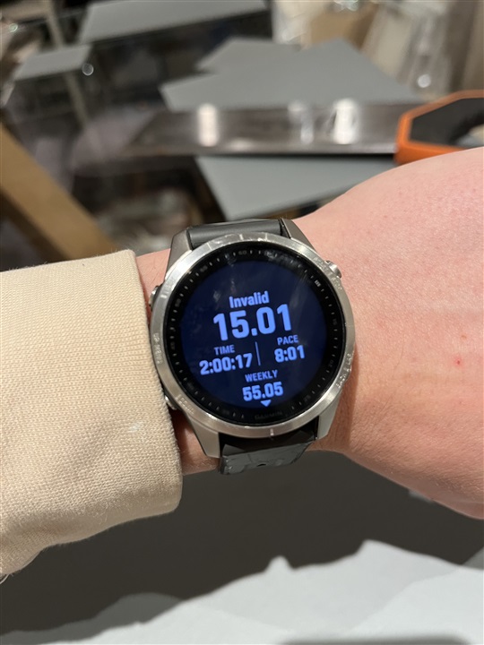

2nd image, the steps and distance do show up for this week

Not sure, I’d just put the watch back on after a quick charge to see if that helped the above problem. My normal resting is around 42-45 so not much different anyway
