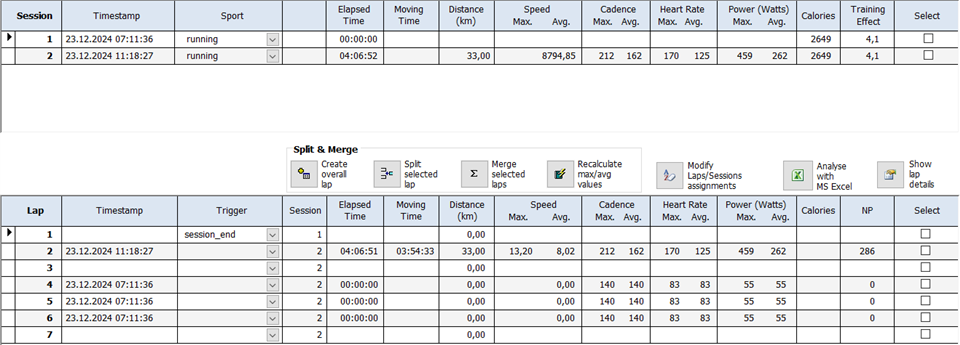

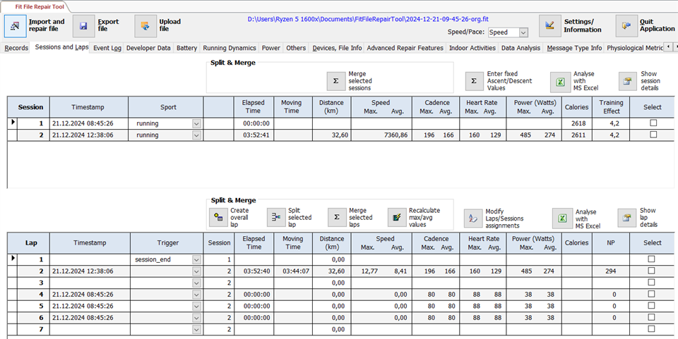

I was able to fix the first one using fitrepaittool. I think the rounds and sessions are messed up.
The second time same thing. Was on watch but couldn't load. But this time it synced with the app but it showed two activity. One that contained the data and an empty one with no data.
