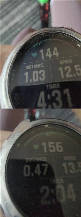

Oh my what a failure!!
It threw my max HR to 200+!
Ok
Tried to put it back where it belongs but oh my, Garmin doesn't read it.
See pic
Tried auto, tried manual, tried HR, tried all the settings, 0 changes!
My Garmin is Completely useless in this state !

    However, in your case, I am not sure at all whether it is a bug or just a misunderstanding of the usage, since you did not post any details. Which activity type is on your screenshots with the HR gauge? Is it Running, Cycling, Walking, or something else? And which HR Zone table is on the other screenshots - is the the general one, or the one for Running or Cycling (I assume it is not the Swimming HRZ table). And if you are looking at the right table corresponding to the activity type you are using, did you try resetting the HRZ table, and adjusting it anew?

    Fenix 7s, hrm pro plus, indoor bike one hour after the 19.24 update and restart of both the watch and the phone
    Got up on it
    My resting HR is 50, max on the bike 155
    Started it with all the sensors connected.
    Surprise!
    Pulse 130 and still in grey zone?
    Ok, stopped and went to see the zones on my watch.
    Max set on 217????
    Ok resetting it on the normal zones for me tried again, no change!
    Resetting it to auto, no change, restart the watch...
    Resetting it to BPM, to max HR, no change??
    My Garmin is completely useless this way, 30 minutes of indoor bike on 130+BPM that should be high aerobic came out with 0 load and 80 kcal?!
    Please correct that or give me back the last update that worked fairly good.

  • Oh my, sorry, went back just to make sure and yes, 214max HR on cycling!
    Hopping back up on the bike and it is correct now!
    It never worked on cycling setting so far but sport HR.
    Oh, saved the day
    Thnx a lot
