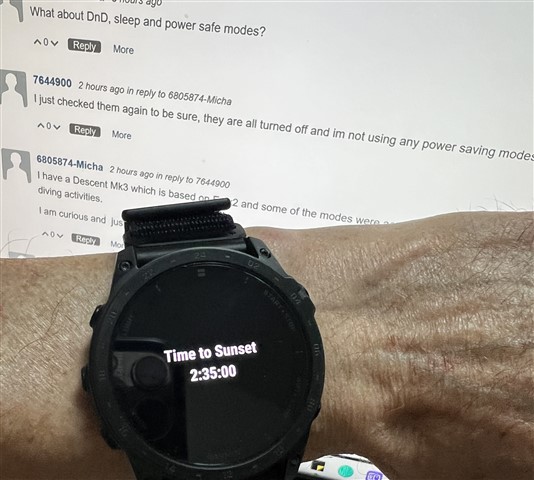

    All I can offer is an existence proof for the Sunset Alert working on my tactix 7 Standard:
    In the Sunset Glance, I set the Alert time for 2:35:00 before Sunset, and it just alerted me.
    The Alert stayed on the screen for about 10 seconds and was accompanied by vibration.
    I use a third party watch face (Glance Pro by Mobile Driveway), so don't think that has anything to do with why your alert is not working.
    HTH
